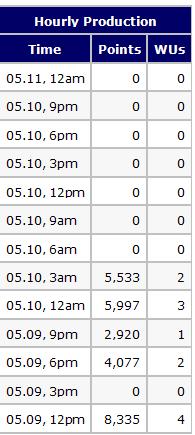

  13. #823
    Join Date
    Oct 2002
    Location
    Earth
    Posts
    1,615
    DANG IT!! Now what?!?!
    (I wonder how many times I've said "DANG IT!" in this thread?)

    Code:
    [06:25:28] Completed 283674 out of 500000 steps  (56%)
    [06:25:33] - Couldn't send HTTP request to server
    [06:25:33] + Could not connect to Work Server (results)
    [06:25:33]     (128.143.199.96:8080)
    [06:25:33] + Retrying using alternative port
    [06:25:33] Connecting to http://128.143.199.96:80/
    [06:26:43] Completed 285000 out of 500000 steps  (57%)
    [06:26:53] - Couldn't send HTTP request to server
    [06:26:53]   (Got status 503)
    [06:26:53] + Could not connect to Work Server (results)
    [06:26:53]     (128.143.199.96:80)
    [06:26:53] - Error: Could not transmit unit 05 (completed May 17) to work server
    [06:26:53] - 19 failed uploads of this unit.
    [06:26:53] + Attempting to send results [May 20 06:26:53 UTC]
    [06:26:53] - Reading file work/wuresults_05.dat from core
    [06:26:53]   (Read 3527457 bytes from disk)
    [06:26:53] Connecting to http://130.237.165.141:8080/
    [06:27:14] - Couldn't send HTTP request to server
    [06:27:14] + Could not connect to Work Server (results)
    [06:27:14]     (130.237.165.141:8080)
    [06:27:14] + Retrying using alternative port
    [06:27:14] Connecting to http://130.237.165.141:80/
    Folding is Fun
    I thought I made a mistake once, but, of course, I was mistaken.
